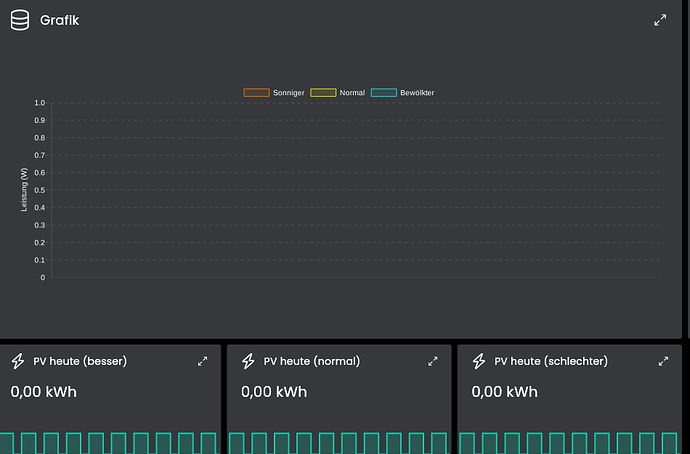

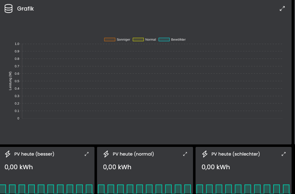

Bei mir leider nicht:
11.10.2024, 00:04:22 | ScriptEngine         | Result for Event 15701
Warning: Undefined array key 0 in /var/lib/symcon/scripts/35725.ips.php on line 163
Warning: Trying to access array offset on value of type null in /var/lib/symcon/scripts/35725.ips.php on line 163
Warning: Undefined array key 0 in /var/lib/symcon/scripts/35725.ips.php on line 164
Warning: Trying to access array offset on value of type null in /var/lib/symcon/scripts/35725.ips.php on line 164
Warning: Undefined array key 0 in /var/lib/symcon/scripts/35725.ips.php on line 165
Warning: Trying to access array offset on value of type null in /var/lib/symcon/scripts/35725.ips.php on line 165
Warning: Undefined array key 1 in /var/lib/symcon/scripts/35725.ips.php on line 167
Warning: Trying to access array offset on value of type null in /var/lib/symcon/scripts/35725.ips.php on line 167
Warning: Undefined array key 1 in /var/lib/symcon/scripts/35725.ips.php on line 168
Warning: Trying to access array offset on value of type null in /var/lib/symcon/scripts/35725.ips.php on line 168
Warning: Undefined array key 1 in /var/lib/symcon/scripts/35725.ips.php on line 169
Warning: Trying to access array offset on value of type null in /var/lib/symcon/scripts/35725.ips.php on line 169
aktuelles Skript von Github + 3 Zeilen am Anfang (require_once - siehe oben) + Austausch (function ForecastData - siehe oben)

Nur zur Info: Die Fehlermeldung kommt jede Nacht, selbe Uhrzeit:
Das Skript funktioniert aber denk ich perfekt! Vielen Dank und schönen Urlaub
Update:
Heute ist noch eine dazu gekommen (funktioniert aber):
23.10.2024, 06:00:20 | ScriptEngine         | Result for Event 31681
Fatal error: Uncaught ErrorException: Operation timed out after 10002 milliseconds with 0 bytes received in /var/lib/symcon/scripts/35725.ips.php:278
Stack trace:
#0 /var/lib/symcon/scripts/35725.ips.php(124): RequestData(Array)
#1 /var/lib/symcon/scripts/35725.ips.php(112): UpdateData('Flachdach_West', Array, false)
#2 {main}
  thrown in /var/lib/symcon/scripts/35725.ips.php on line 278
Das ist der Midnight Update RUN ??? Da wird das Archive entsprechend für den neuen Tag vorbereitet!
Das war aber ein Timeout, d.h. es gab keine Connection zu SolCast!
Kann es auch sein das um Mitternacht der Request irgendwie bei Dir blockiert wird (Zwangstrennung, Netzwerkeinstellungen, was weiß ich :)?
Gruß HEiko
Hallo @pitti,
ich glaube, der Fehler mit dem Mitternachsupdate ist auch in meinem Verbesserungsvorschlag an Dich gefixt… Hatte Dir das mal vor einiger Zeit als PN geschickt, es ging damals aber vor allem aber um die Skalierung der Werte bei BKW < 1kW.
geht bei Euch die Abfrage von Solcast?
@pitti: Es wird der String nicht mit Daten befüllt.
Die Token und die rid sollten passen.
Wenn ich die JSON downloade sind da ich Daten drin.
Kannst du mir einen Tipp geben?
Danke.
Bei mir ist auch alles leer.
Wenn dich den Link:
Solcast API
mit meinem Token öffne, kommt Forbidden.
Ich habe denflaschen Link.
richimaint
Danke für die Info.
Dann ist es ein Zentrales Problem.
Also wenn ich den Link, den mein Skript zur abfrage in den Browser eintrage, öffnet sich auch die Seite mit der JSON, also passt der Link auch.
Dann müsste das Problem nach dem Aufruf der Funktion mit (Curl-Abfrage) sein?

Brauche ich den token nur zum verifizieren? Das wird im Curl Abruf gemacht.
@richimaint
Wie lange bekommst du schon keine Daten mehr?
Ich seit dem 15.11.
Laut meinem Logging, am Samstag.
richimaint
Moin, jetzt sind die Daten bei mir für morgen u. Dienstag wieder vorhanden.
Gruß Gerd
bei mir auch
richimaint
