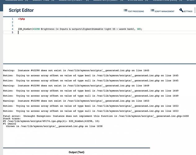

Hi Jürgen,
I putted several devices in a group; but still if I change something via symcon in a group all threads are used.
How to send commands to the Deconz in the most optimal way? (to use as little threats as possible). Right now I use RequestAction($target, $goalvalue);
$target = zigbee device (brightness)
$goalvalue = desired brightness

Hi Jurgen,
thank you for clearifing
I tried this in the lights, according to zigbee2deconz/Light at master · nefiertsrebliS/zigbee2deconz · GitHub
But if I select the mother nothing happens? If I select ‚brightness‘ an error occurred.
A restart fixed ’ Z2D_DimSet(37065, 45); ’
but still with this script all treats in symcon are used!
Thats normal especialy, if you have a big number of devices. But it has to disapear or change within milliseconds. If there is something wrong, the wrong threads are marked red. If they are white, all is fine.
Did you also test it with a lightgroup? Does that work?
Best Regards
Jürgen
