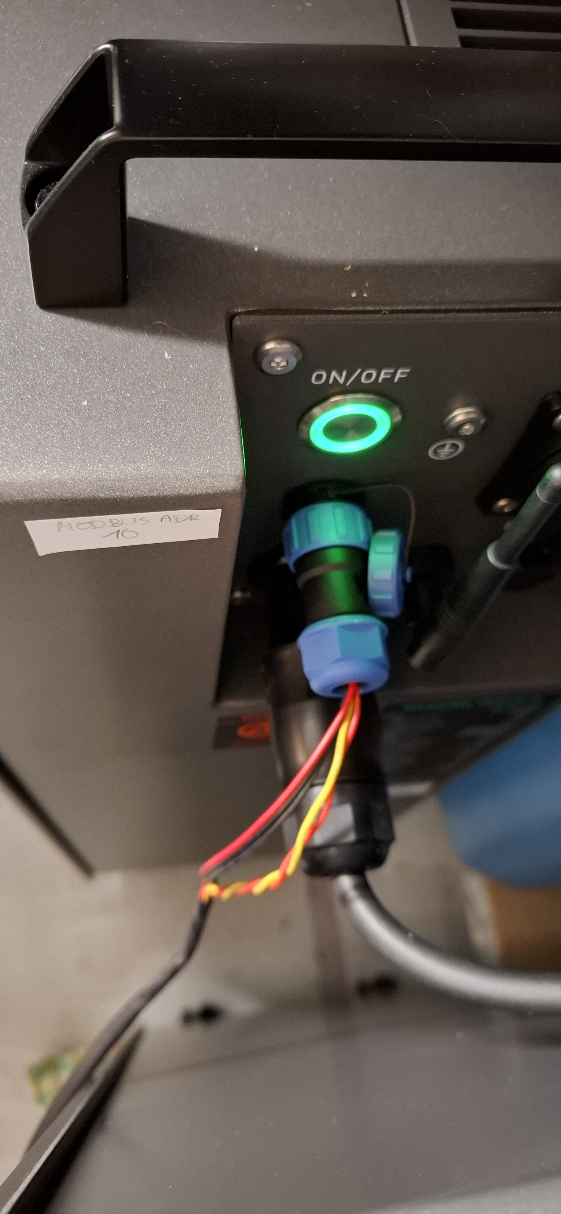

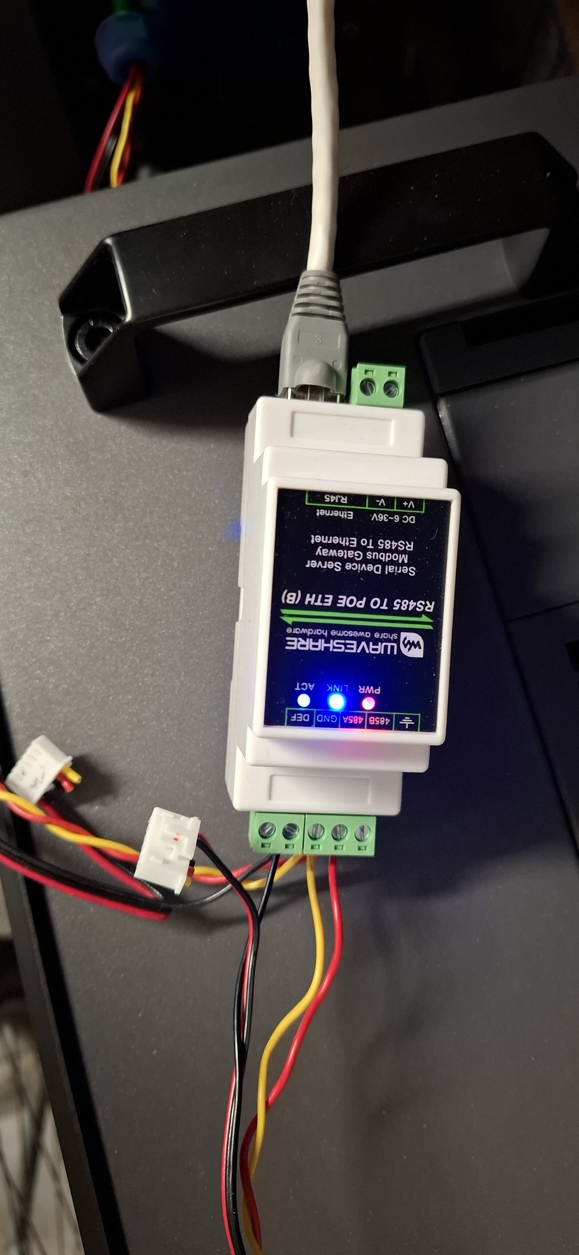

As the API of Marstek is still in development, I used modbus as teh way of communication with the Marstek Venus. This means that you will need to connect the round modbus cable (it is supplied with your venus) and connect that to an R2484 serial port. This RS485 port can be a raspberry Pi hat, a USB to RS2845 or an RS485 to ethernet (I used the „Waveshare RS485 naar RJ45 Ethernet Converter Module“).
Check that you connect the A/B wires correctly. AS I used PoE (power over ehternet), I did not need to connect an additional powersupply.
In case you like to use a USB to RS485, you shoudl be able the use this waveshare or another brand.
