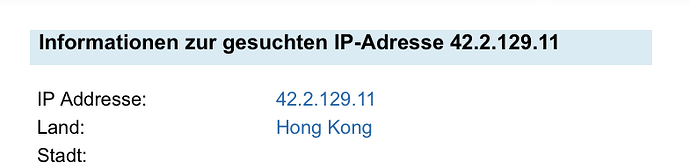

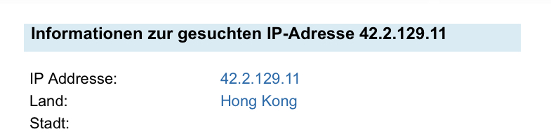

a.) kann man irgendwo eine statische IP eingeben?
b.) Ist der DNS Server 42.2.129.11 ok?
Glaube nicht - ich hab’s über die Fritzbox festgezurrt!
Wo haste das den her? Wo willst/hast Du das eingestellt? Wüsste keine Option in Configration dafür?
Gruß Heiko
Das hat sich selbst so eingestellt - also Standardeinstellungen. Ich glaube unter „Informationen“ stand das.
Vielleicht bin ich ja zu misstrauisch…

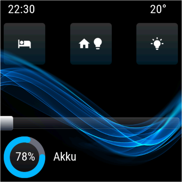

Hier mal mein Background Design. Wird sich bestimmt noch etwas verändern:
{"page":0,"id":1,"obj":"label","x":20,"y":0,"h":40,"w":250,"text":"Außentemperatur:","align":0,"bg_color":"#2C3E50","text_color":"#FFFFFF"}
{"page":0,"id":2,"obj":"label","x":396,"y":0,"h":40,"w":110,"text":"23.2°","align":0,"bg_color":"#2C3E50","text_color":"#FFFFFF"}
{"page":1,"id":10,"obj":"img","src":"L:/bg2.png","auto_size":0,"w":480,"to_back":1}
{"page":1,"id":1,"obj":"btn","x":9,"y":60,"w":110,"h":110,"toggle":true,"text":"\uE2E3","text_color":"#FFFFFF","text_font":36,"bg_opa":50,"bg_color":"#FFFFFF","border_side":0,"mode":"break","align":1}
{"page":1,"id":2,"obj":"btn","x":185,"y":60,"w":110,"h":110,"toggle":false,"text":"\uE2Dc\uE335","text_color":"#FFFFFF","text_font":36,"bg_opa":50,"bg_color":"#FFFFFF","border_side":0,"mode":"break","align":1}
{"page":1,"id":3,"obj":"btn","x":360,"y":60,"w":110,"h":110,"toggle":true,"text":"\uE6E8","text_color":"#FFFFFF","text_font":36,"bg_opa":50,"bg_color":"#FFFFFF","border_side":0,"mode":"break","align":1}
{"page":1,"id":4,"obj":"slider","x":9,"y":310,"w":465,"h":30,"min":0,"max":100,"bg_opa":50,"bg_color":"#FFFFFF"}
{"page":1,"id":5,"obj":"arc","x":9,"y":360,"w":110,"h":110,"min":0,"max":100,"border_side":1,"type":0,"rotation":0,"start_angle":0,"end_angle":360,"start_angle10":0,"end_angle10":360,"adjustable":false,"bg_opa":50,"bg_color":"#FFFFFF"}
{"page":1,"id":7,"obj":"label","x":40,"y":390,"h":50,"w":55,"text":"0","align":0,"bg_color":"#2C3E50","text_color":"#FFFFFF"}
{"page":1,"id":8,"obj":"label","x":140,"y":390,"h":50,"w":70,"text":"Akku","align":0,"bg_color":"#2C3E50","text_color":"#FFFFFF"}
{"page":2,"id":1,"obj":"label","x":100,"y":180,"h":150,"w":300,"text_font":128,"text":"23:15","align":0,"bg_color":"#2C3E50","text_color":"#FFFFFF"}
{"page":2,"id":2,"obj":"btn","action":{"down": "page prev"},"x":150,"y":400,"w":190,"h":64,"bg_color":"#2C3E50","text":"\uE141","text_color":"#FFFFFF","radius":10,"border_side":0,"text_font":24}

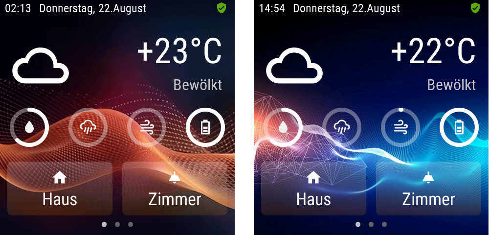

Hier ist meine Visualisierung, welche ich vor allem durch die Community hier zu Stande gebracht habe.
PageOne
PageThree
PageTwo
a
Meine
Sieht auch gut aus. Woher kriegst du die Regenprognose?
