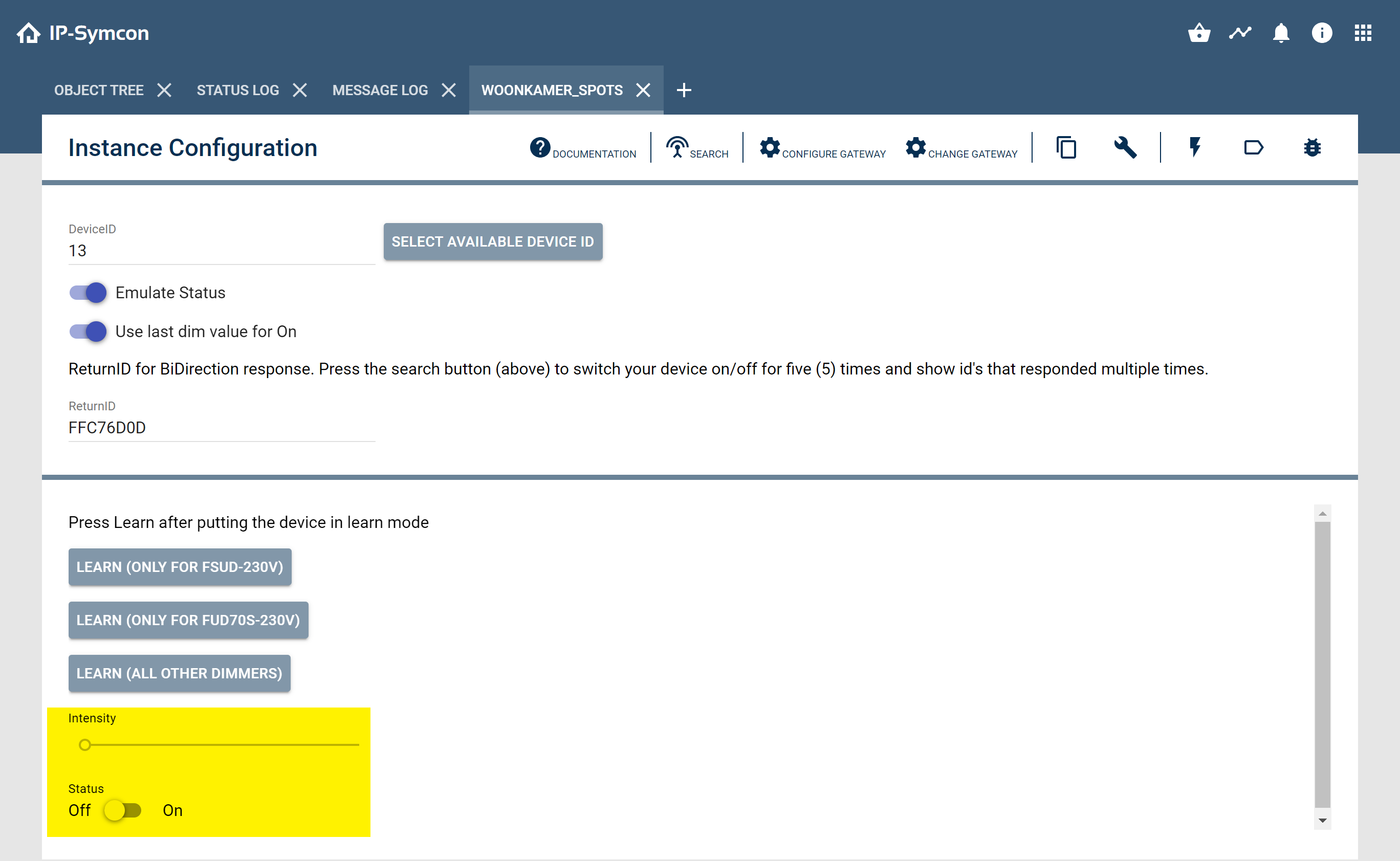

I’ve been using scripts created by @Attain for years, does this mean I can drop those scripts?

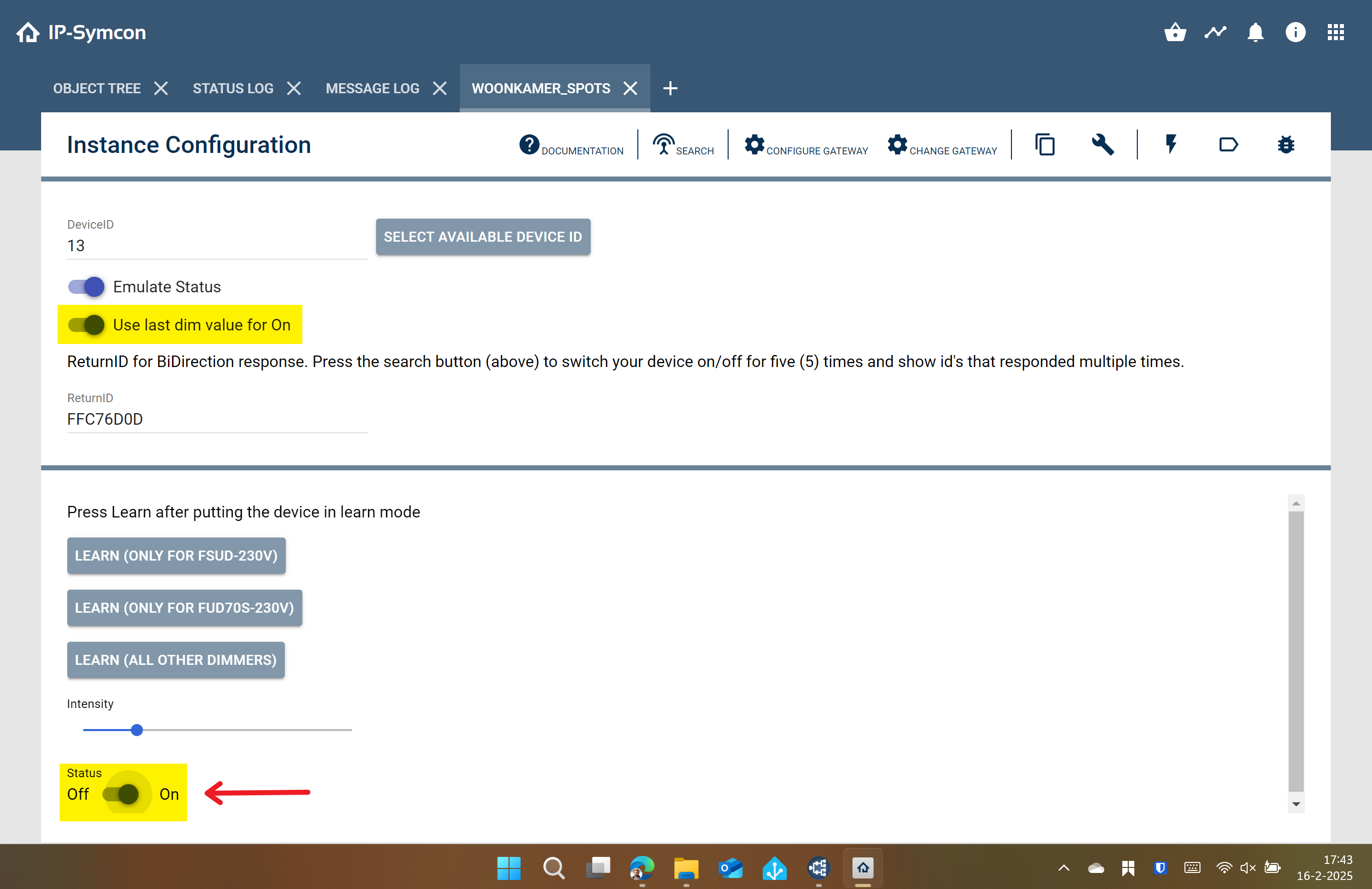

If I enable the new „EnOcean: Option to switch on the Eltako dimmer to the last dim level when On“ the „On“ status is non-functional, it doesn’t respond at all (Or it sends an ‚on‘ command with zero brightness, if I had to guess)
Hm. Is there any error if you would switch through the visualization?
I will double check if we made an error while implementing :sweat_smile:
On which Value is the IntensityVariable?
There is no error when trying to switch the light to on, but I think it doesn’t even try to change the status. If I change the status to „off“ in the visualization the „IntensityVariable“ changes to „0“. (The brightness was set to 22% or 20%.) I’m unable to change the status from „off“ to „on“ using the on/off status. The only way to turn on the light is to send a dim value.
