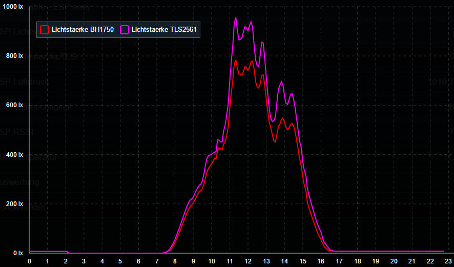

I am comparing both sensors since months with each other. The TSL2561 is a little bit more sensitive than the BH1750 (see the first graphic). However, the TSL2561 has sometimes dramatic spikes upwards (see the second graphic). Therefor I will stay with the BH1750.
Strange, i do not have those issues with my TLS.
