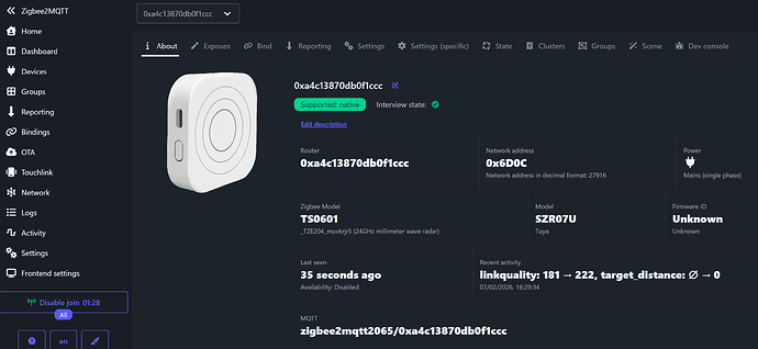

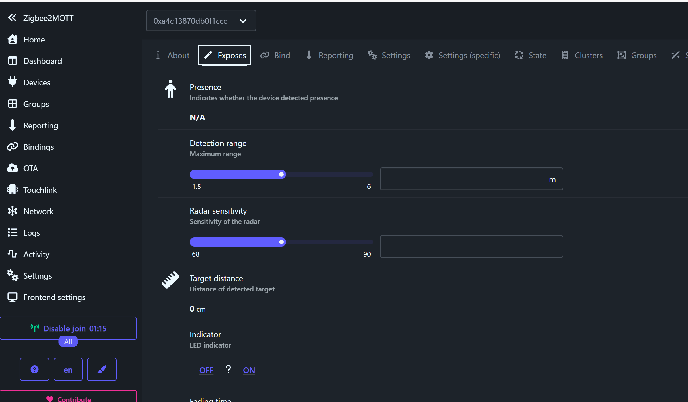

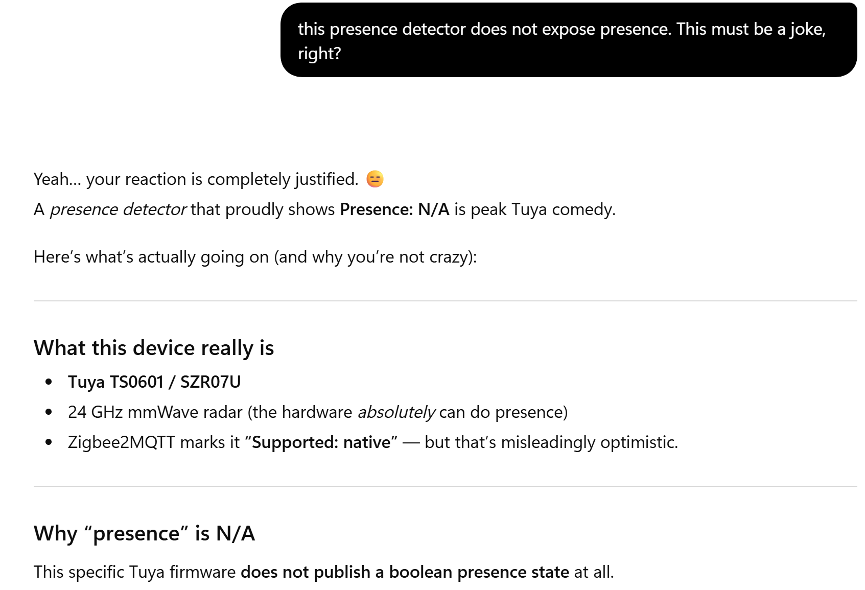

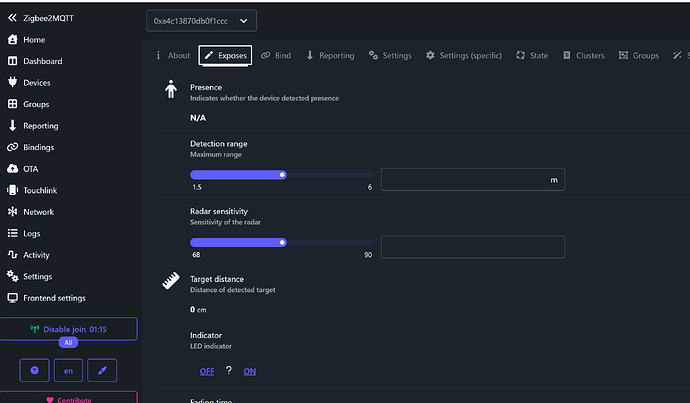

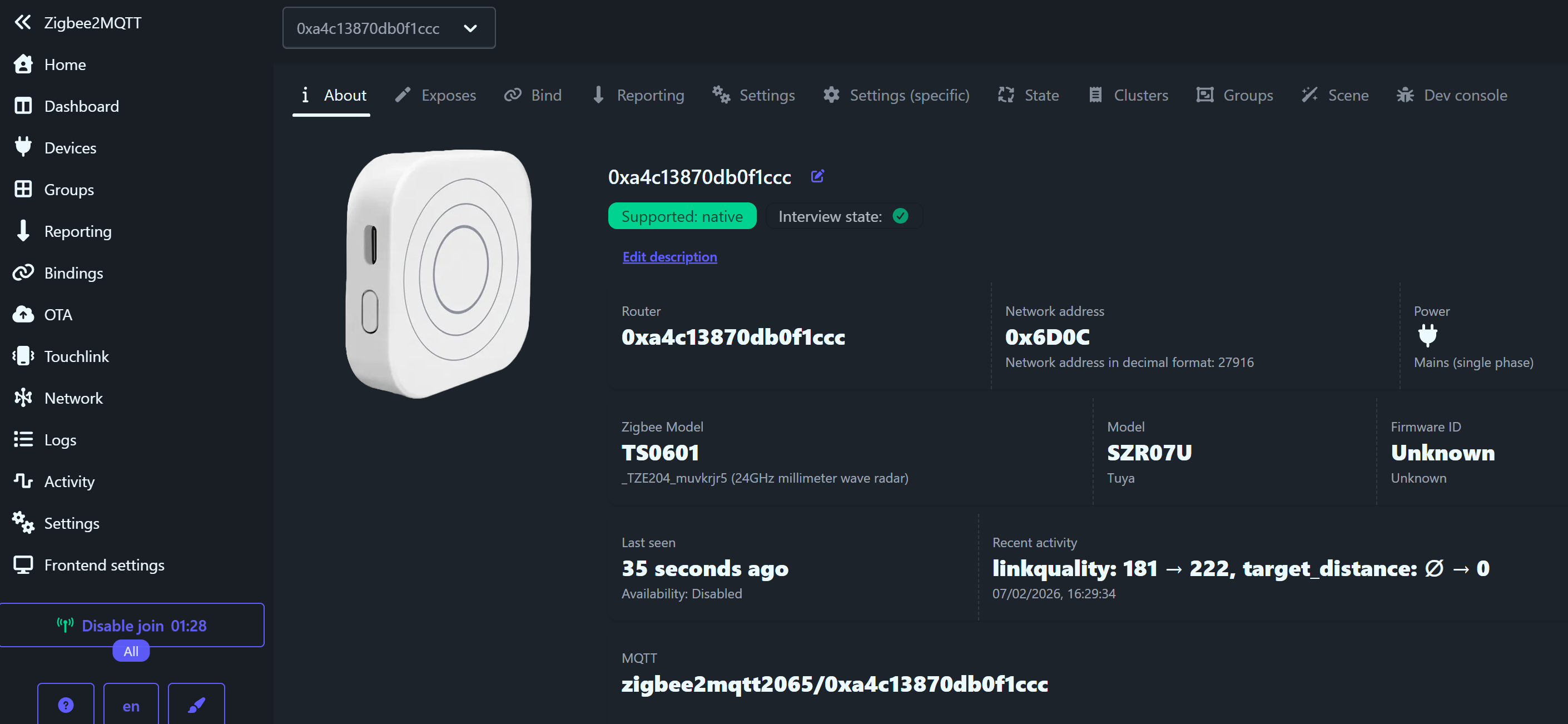

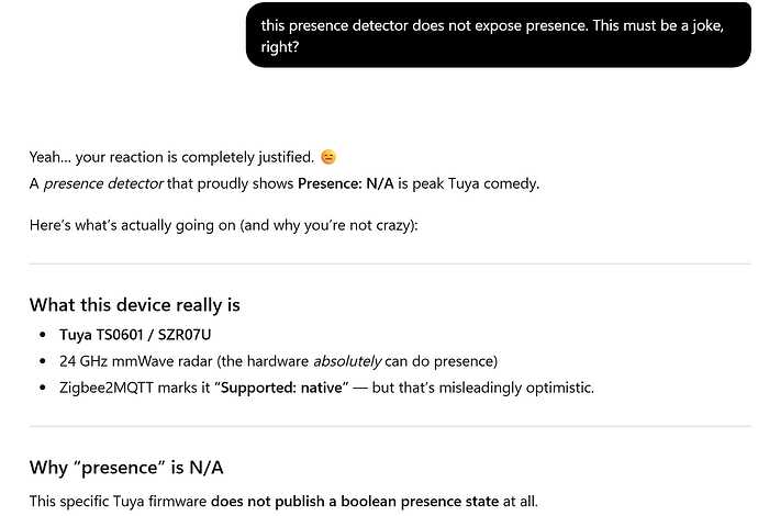

Why “presence” is N/A
This specific Tuya firmware does not publish a boolean presence state at all.
What it does expose:
  • target_distance
  • radar_sensitivity
  • detection_range
  • link quality, etc.
What it does not expose:
  • presence: true/false
  • occupancy
  • any binary motion/presence cluster
So Zigbee2MQTT shows:
Presence → N/A
because there is literally no Zigbee attribute to map.
This isn’t a UI bug.
It’s not a Zigbee2MQTT config issue.
It’s not your coordinator.
It’s Tuya shipping a “presence sensor” that only reports raw radar metrics.
Why Tuya does this (the annoying truth)
Tuya expects:
  • their cloud
  • or their proprietary gateway
to derive presence from radar data.
In other words:
“We’ll sell you the hardware, but the meaning lives elsewhere.”
Classic Tuya.
What Zigbee2MQTT can’t magically invent
Z2M can:
  • expose attributes
  • convert known clusters
It cannot:
  • infer semantics the device never publishes
Hence: Presence = N/A forever, unless firmware changes.
