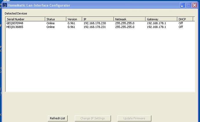

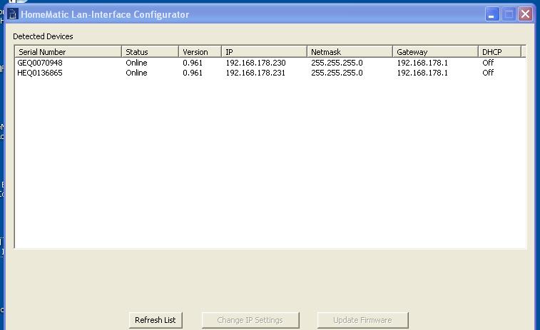

Kann mir mal jemand mit dem 2ten Lan Adapter helfen ?
Ich bekomm den einfach nicht aktiv ! die Powerlampe blinkt… Verbindung ist aber da.
BidcosService
# TCP Port for XmlRpc connections
Listen Port = 2001
# Log Level: 1=DEBUG, 2=WARNING, 3=INFO, 4=NOTICE, 5=WARNING, 6=ERROR
Log Level = 1
# If set to 1 the AES keys are stored in a file. Highly recommended.
Persist Keys = 1
Device Description Dir = ${Bindir}\devicetypes
Device Files Dir = ${CommonAppData}\Bidcos-Service\devices
Key File = ${CommonAppData}\Bidcos-Service\keys
Address File = ${CommonAppData}\Bidcos-Service\ids
Log Destination = File
Log Filename = ${CommonAppData}\Bidcos-Service\log\bidcos-%Y-%m-%d.log
[Interface 0]
Type = Lan Interface
Serial Number = GEQ0070948
# The encryption key is found on a sticker on the lan interface
Encryption Key = 2A8C62B10A701EC1D7E9FB628165FCA7
Description = First Lan Interface
# IP Addess is optional. If not specified, the Lan Interface is
# detected by its serial number.
# You may have to use the IP address if your lan interface is behind a
# router or a firewall.
IP Address = 192.168.178.230
[Interface 1]
Serial Number = HEQ0136865
Encryption Key = CC7589A681B6B183457DDF80A33568F4
Description = Second Lan Interface
IP Address = 192.168.178.231
