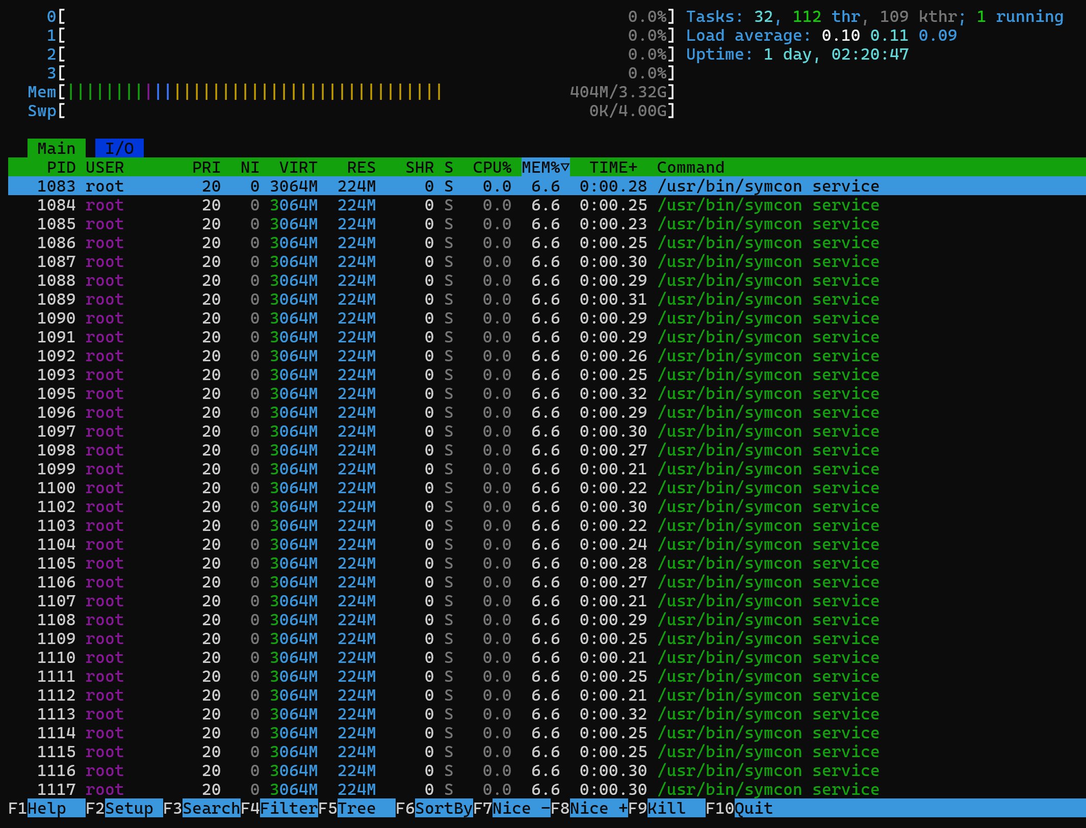

Well, the apt source issue is the least of the problems. Symcon doesn’t work at all on Ubuntu 26.04. It consumes all available memory until the system hits a kernel panic.
Look at this:

Google Gemini gave the explanation below. If that’s accurate, then something in the memory‑management behavior must have changed between Ubuntu 24.04 LTS and Ubuntu 26.04 LTS. IP‑Symcon is still running :wink:
Why the Kernel killed it (The Virtual Memory Trap)
Since you don’t have systemd-oomd installed, we know the „Userspace Killer“ didn’t do it. Instead, the Kernel stepped in because of a rule called Overcommit Accounting.
  1. The Promise: When symcon starts, it tells the Kernel: „I might need 3.1 GB of space eventually“ (that’s your VSZ).
  2. The Check: The Kernel looks at: Physical RAM + Swap.
  3. The Failure: When Hyper-V had your VM squeezed down to 2 GB, the Kernel did the math:
    • Available: 2 GB RAM + 0 GB Swap (if swap hadn’t kicked in yet).
    • Requested: 3.1 GB.
    • Result: „I cannot promise 3.1 GB if I only have 2 GB. To prevent a total system freeze, I must kill the requester.“
How your fix solved it without the tool
By raising the Hyper-V Minimum RAM to 4 GB, you changed the math for the Kernel:
  • Available: 4 GB RAM + 0 GB Swap.
  • Result: „I have plenty of room to cover that 3.1 GB promise. Carry on.“
You don’t need oomctl because the „Safety Officer“ (the Kernel) is now satisfied with the amount of floor space you’ve provided. The error was legitimate, the Kernel truly believed it was out of „promisable“ memory because the virtual request was larger than the physical hardware being allocated by Hyper-V at that moment.
